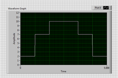

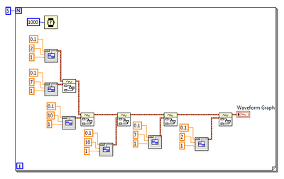

Hi GerdW,
    Here I have attached a file. I have used square wave function in labview to create step signal I need. I have done it. But when I run a program for more than one or two times using for loop, waveform shape has changed as in the attached image below. Why  is that?
ProgramProgramunwanted waveunwanted waverequiredrequired
Best Regards,
Dhans 😉
Kudos are welcome 😉
Aspirant Labview Programmer (Labview 14) 😉
Message 16 of 19
(2,154 Views)
Accepted by dhans
Hi dhans,
use all inputs of the signal generation function - as I did in my snippet...
Message 17 of 19
(2,150 Views)
Yeah, I did like that. isn't it? seems your snippet and my snippet looks like same? where is the error?
Best Regards,
Dhans 😉
Kudos are welcome 😉
Message 18 of 19
(2,147 Views)
Hi GerdW,
Thank you for the reply. I have missed a duty cycle input in the square wave generator. Now
I have added an input of 100 dbl to that input, i.e, 100% duty cycle. Now it works fine.Smiley HappySmiley Wink
