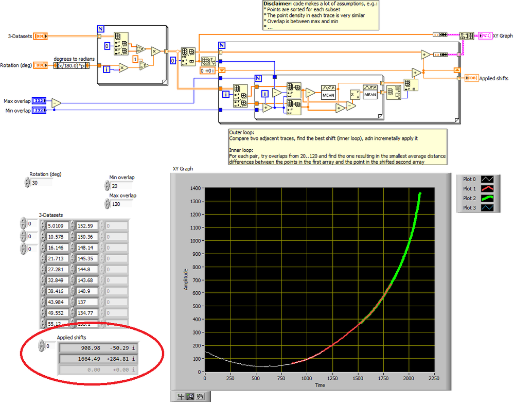

To simplify the analysis, we need to make certain assumptions, for example if we can assume that the point density is similar between all the traces (and they probably are!), we could do something as follows. It seems to get the same shifts as you automatically (within ~0.5). In the most general case, this is a hard problem, though.
I am sure there are many other ways to do all that.
Note that things simplify dramatically when using complex datatypes. No subVI needed for shifting and rotating. The first loop just applies the 30 degree rotation.

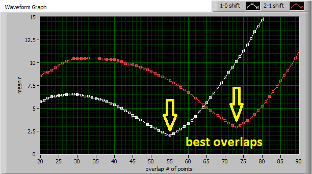

As a quick followup, here's a graph for the "mean r" difference after shifting as a function of overlap. The min is the optimal overlap and the mean of the point differences is the optimal xy shift.

Thanks Altenbach, works like a charm!
No need to optimize the rotation, it’s always 30 degrees.
Processing the full data through your code returns the expected circle.

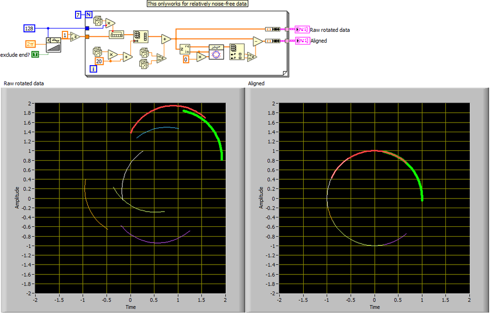

If it really is a circle, you might be able to use "fitting on a sphere" (works for circles if you keep z=0), then align the centers. There even might be a global solution that forces all r to be equal, but that would need to be written first. 😄

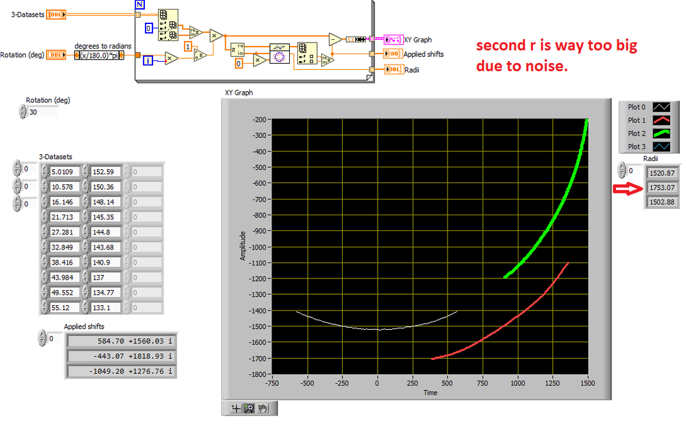

Nah, too much noise. (It would work for noise-free data, even if there are gaps or no overlaps at all! :D)
In fact, that's the first thing I tried yesterday, then decided it's probably not a circle. 😄
In your case, the second set results in a larger radius (200+ larger!), causing gross misalignment. I still think that entire things could be rewritten to globally force a single radius, but unique center for each trace.  Here's a discussion of the current algorithm for fitting on a sphere.
Basically, we would have N traces, N midpoints, and a single radius. Somebody could investigate (not me at the moment ;)).
As you can see below, it works perfectly for noise-free simulated data:

But a perfect circle exist on black board and drawing paper, in real world … … … can be a bit un-circle.
Segment 2 has a “flat part” in the middle returning that way larger radius.
So I tried to use the peaks & valleys (what you call noise I suppose) as beacons to match the segments. Some kind of cross correlation but then in 2D. Unfortunately, not being a mathematician, I don’t know how to implement this, thus started this thread!
