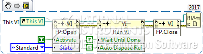

@plpablo wrote:
Don't wait until done the VI executes, just make it false and let it run. Use below shown logic it'll work,
