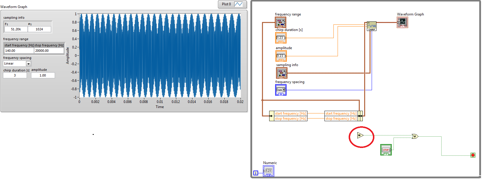

I'm creating a chirp signal to be displayed in a waveform graph.
The frequency of my signal is from 140-20kHz. I want to stop my while loop when the frequency is already 20 kHz and able to display the plot at that frequency. What should I set in my stop condition in the while loop. ASk.png
Here is my VI.

Here is my VI

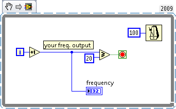

Hi gjjude,
Try this one. Probably the solution.
Vijay
Message 3 of 10
(6,192 Views)
I could be wrong but I'm pretty sure this does exactly the same while cutting down on unnecessary comparisons.
/edit: Okay, I see a difference, the Shift Register would contain a zero if you use the Stop Control to exit the loop. Anyway, the lower equals? comparison can definitely be skipped.

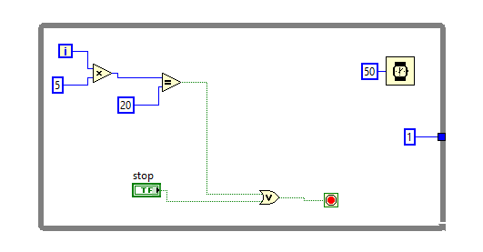

Could you explain how this one works?
Message 5 of 10
(6,119 Views)
(Does it? Does not seen to have much to do with the question....)
Sorry, I don't quite understand your problem. Who is modifying the "frequency range" control during the run?
In any case, NEVER do "equal" comparisons on floating point numbers. At least, do a "larger or equal" instead of an "equal".
And why does the loop need to stop to display the result? I also don't have your toolkit, so I cannot test further.

I strongly belive to altenbach qouted "In any case, NEVER do "equal" comparisons on floating point numbers. At least, do a "larger or equal" instead of an "equal".
and I think you don't need the stop button(what the use?) if you want to stop it automatically  when it reach the count 20,
you can do like this
Thank you & Best regards

The vi you are using generates a chirp waveform.  if you want the loop to stop when the chirp is at 20hz set up the parameters so that the stop frequency is 20 hz an run the loop once in fact- you dont need a loop at all!
