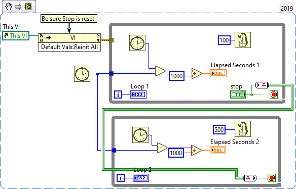

You want one Stop button placed "somewhere" to stop two parallel loops.  As I said before, this is a job for a Tag Channel.  The Stop button can really be almost anywhere inside the VI (I placed it in one of the Loops, but because the Tag Channel can branch, you can add additional Channel Readers to "catch" the Stop request.
This is your original example, with changes, showing Tag Channels to stop both loops.  I'll note the changes below.
  1. I reset the Stop button to its default "Latch when Released" mechanical action.
  2. I used "Reset all values to default" and tied it to the first loop via the Error Line to ensure that the Stop button starts "False".  No Frame Sequences needed!
  3. I used Tick Count (ms) to get a better estimate of time for measuring Elapsed Time (read the Help).
  4. I made the top loop the "fast" loop, and put Loop Counters in which make it more obvious which loop is running faster.
  5. I used a Tag Channel to take the Stop value to the second loop.
This works.
Bob Schor
