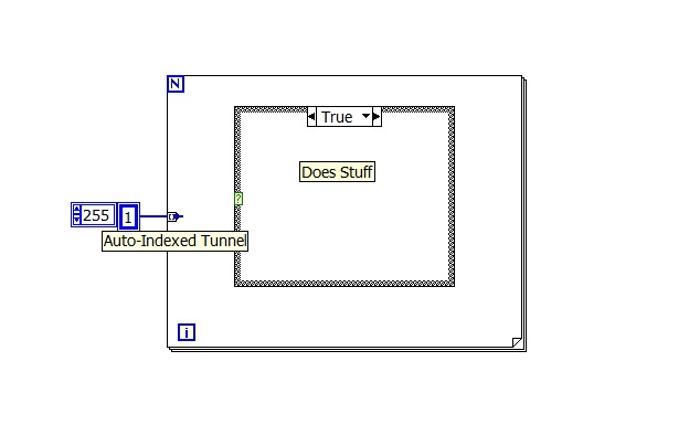

How would I stop a while loop after the last element of a 2d array.  I tried wiring an uninitialized array constant, and comparing it with the 2d array, which was indexed to a 1 d array, but that didn't work.

What's wrong with just using a FOR loop with autoindexing tunnels?  Maybe you should give more context of exactly what you are trying to do.

Accepted by topic author fghfghgfhfhg
Hahaha, hey, it's true what they say, a picture is worth a thousand words
