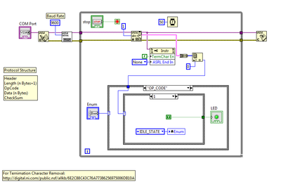

Finnaly I did Something, which is as follow
I created four states using enum -> IDLE_STATE, LENGTH_STATE, OP_CODE, DATA, CHECKSUM
Whenever i receive data serialy, based on the Current State i checked which type of data it is, like if i am in IDLE_STATE then i will check for header, if it is header then i will move to the next length state and if not then IDLE_STATE will remain idle.
To change the state of enum automatically in code i use local variables. (Will Hide the front panel control of enum as it is not required there)
Then in LENGTH state i do nothing just incrementing the enum state to OP_CODE State.
Then in Op_Code state if Op_Code is 1 then i light the led control otherwise not.
So this packet
0x2C 0x12 0x02 -> Turn off LED
and
0x2C 0x12 0x01 -> Turn on LED
Length has no meaning right now, i think declaring length as global variable will work for me.

1. I suggest you learn how to use Shift Registers instead of locals and globals.  They are a lot more efficient (memory and execution speed) and make it a lot easier to read the diagram.
2. You do not need that property node inside of the loop.  There is an input to the Configure Serial Port for turning off the termination character.
3. You do not need the wait because the VISA Read will limit the loop rate if no data is coming in.
4. Once you have the length, you can just read the rest of the entire message and process it all at once.  This will make things A LOT faster.
5. You really should make that enum a type def so that you can make sure all of your enum constants have the same possible values.  If you have to add a state later, you only have to update your enum in one location then.
GCentral
