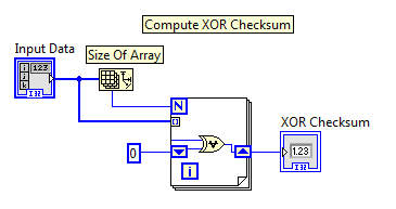

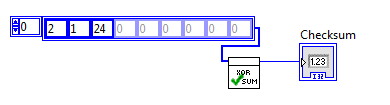

Hey Thanks for your reply.
I did it, created a separate SUB VI to calculate the XOR Checksum.
Is it okay, please suggest if you find something worng in this.
Now i will use this Sub VI in my main project.
Message 16 of 27
(2,296 Views)
Accepted by topic author xpress_embedo
That will work.
But you don't need array size or to wire it to the N.  With auto-indexing the For Loop will automatically the number of times for the number of elements in the array.
Message 17 of 27
