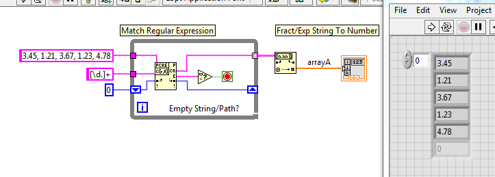

While personally I am opposed to such code if you really wanted to the below code snip would work...

Why go through all of  that when you could just use a spreadsheet string to array function?
Message 7 of 15
(10,310 Views)
Oooo.  I have not messed around with the spread sheet functions before!  I like that...
Much better than mine. Smiley Tongue
