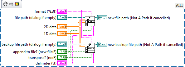

It's all about the method you want to write. Assuming you want to always backup what you write, I'd create a wrapper for your write functions to take two inputs, and write two files all the time. In your example, I'd replace the write Spreadsheet Vi with something like this:
Which will request two paths and both files will be written the same way. You control it when you want to save data. Not some external program.
"I won't be wronged. I won't be insulted. I won't be laid a-hand on. I don't do these things to other people, and I require the same from them." John Bernard Books
(3,886 Views)

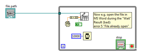

I Think you must have missunderstood me; the problem is you cannot open and write to a file while another external program has it opened too with exclusive access. Consider following code:
If you open the file during the "Wait" (it is closed then because "Write to Spreadsheet" does open, write, close) e.g. with MS Word wich does an exclusive open (allowing exclusive access only) then during the next loop your program will crash with error 5.

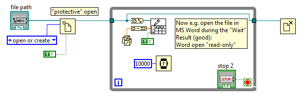

The solution I mentioned is to open it first in LV an keep it open all the time:
which prevent e.g. MS Word to open it exclusively but read-only!
