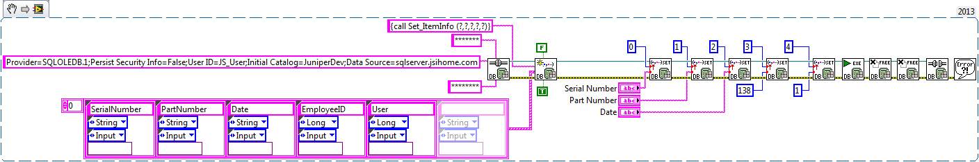

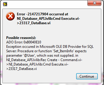

If I try to run the stored procedure code I get an error saying I am not providing a required input, but from the LabVIEW it looks like I am providing it.
But I keep getting this error.

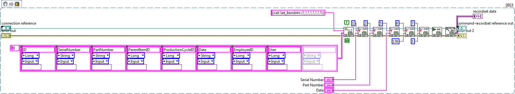

The procedure isn't going to match up the parameter names with the values you provide.  You only provide 5 params but there are 8 in the stored procedure.  In your case, SerialNumber will be passed into ID, PartNumber into SerialNumber, etc.  Add some blank params in your cluster if they aren't required.

Actually what i said may not be entirely true.  It depends on the definition of the SP itself.  Your picture just shows a list of the parameters but not necessarily in the same order as defined by the SP.

Thank you very much.  That is exactly what I needed.  I guess I was confused because my IT Database manager said those values were not required, but LabVIEW must require them.  I put all of the paramaters in and just updated the ones I needed to.  This solved my issues.

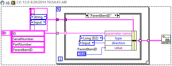

FYI, this is the way that i like to create my parameters.  Hope it helps.
aputman
