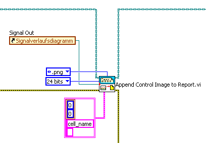

Hello
"Another issue I am having is with graphing in Excel. Is there a way I can export a graph directly from LabVIEW to Excel without using the Excel functions?"
I insert frontpanel graphs directly this way:
20435i1B87D87B9DF24CDC
Message 2 of 9
(4,335 Views)
Hey Matthias,
How did  you get that to be your ctrl reference? I cannot find the graphs that are on my front panel as a constant..... in other words, what constant did you choose?  Thanks for the quick response!!
Message 3 of 9
(4,321 Views)

Hello
"How did  you get that to be your ctrl reference?"
Right click on your frontpanel graph/chart you want to intert and chose "Create - Reference".
Message 7 of 9
