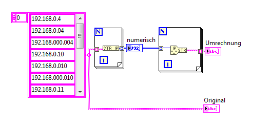

For some reason I used the String form "192.168.0.030" and found that the result in numerical representation (using the Str-IP Function in TCP Protocol Palette) is different if you compare it to the form "192.168.0.30". This seems to appear at least for all IP numbers from ".10" to ".99" in the last position.

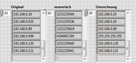

grafik.pngThe re-conversion using the corresponding IP-to-Str function works correct except one very strange case where the conversion of "192.168.0.099" results in back-conversion as "255.255.255.255".
The errors disappear for IP values > ".100" in the last position

I don't have an answer but it looks like there is another case that is strange.  The 192.168.0.020 re-conversion yields an incorrect result of 192.168.0.16.
In the case of .020, the re-conversion changed it to .16 in your example.

Hmmm Something strange here with Octal <-> Decimal.
.020 becomes .16
.070 becomes .56
70OCT is 56DEC
20OCT is 16DEC,

No, the re-conversion takes the wrong conversion number as input. This results in the error.

could be the answer - numers with leading 0 are interpreted as octal. But 099 does not exist in octal!
The String To IP function accepts standard decimal, octal, or a combination of both number systems. If you enter a leading zero into a string, the String To IP function interprets the string as an octal number.
^^ from context help. LOL (Should have read it sooner).
Mystery solved.
