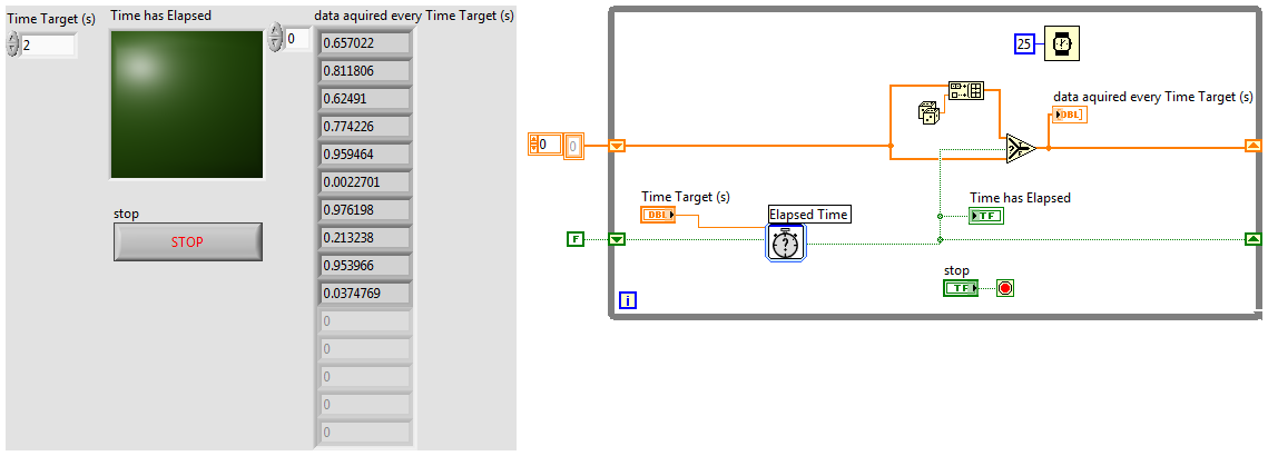

i wouldnt use "wait" function for your software timing...you can use elapsed time or any of the other timing functions

If you have a long wait function within a loop, nothing can happen until that time is up.  Suppose you decide to hit the stop button.  You'll be forced to wait up to 5 minutes for the wait to finish (possibly almost up to 10 minutes depending on the way your code is setup) for the VI to detect the stop and end the loop.  Someone will thing the program has hung up.  If you have a quicker loop, but a case structure that only executes when the Elapsed time has occurred, then  you can react quickly to other events such as the user hitting the stop button.
