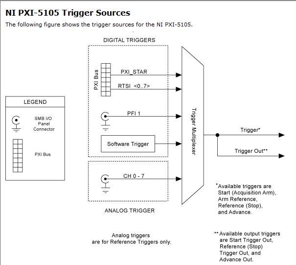

If you look at the HELP documentation that is installed with the NI-SCOPE driver, the PXI-5105 can both received and send triggers through specific channels (see image below).
Have you tried using some of the examples in the example finder?
Path: Hardware Input and Output > Modular Instruments > NI-SCOPE (High-Speed Digitizers) > General
