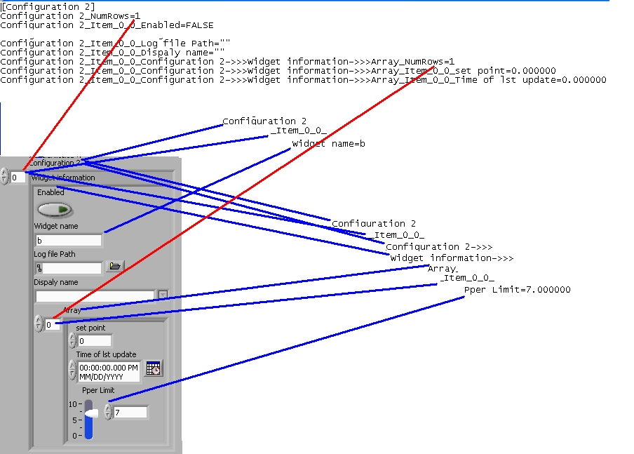

I think you are missing that I already developed the system that Ben displays above. It reads/writes controls recursively to/from an XML file. It works great except for with arrays because my system takes a control reference as the input rather than a value. The reference is used to get the label names and use them as keys to form the "XML path". The reference is also used so that when we are handling a cluster, it will recursively build the XML into other clusters that that cluster contains (similar to Ben's example). I know exactly how array indexing works, but the way that LabVIEW handles arrays and lets you access them is very restrictive.
Here you can see a cluster that is going to be converted to XML. You can see the results of it through my system.

I think you are missing that I already developed the system that Ben displays above. It reads/writes controls recursively to/from an XML file. It works great except for with arrays because my system takes a control reference as the input rather than a value. The reference is used to get the label names and use them as keys and form the "XML path". The reference is also used so that when we are handling a cluster, it will recursively build the XML into other clusters that that cluster contains (similar to Ben's example). I know exactly how array indexing works, but the way that LabVIEW handles arrays and lets you access them is very restrictive.
In the code included in my nugget I manged to get it to work by defering FP updates (to hide it from user), set array to only have one visable element, set the index to display the array element I wated to look at, then used the element ref to get the value and then restoring the control appearence, and setting the control ref back to where it was when it started.

Thank you! That was exactly what I needed, I simply changed it to only show one element at a time and it works like a charm.
