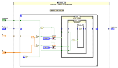

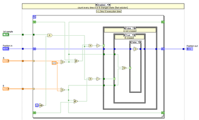

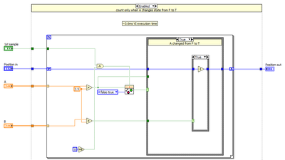

I made a VI which counts the pulses from a quadrature encoder using the boolean crossing.vi and noticed very high CPU usage while the VI is running. A and B signals are received from the encoder which generates 0-5V levels using a cRIO with NI 9223 AI modules. I found that if I implement the logic behind boolean crossing.vi in my For loop, the VI execution speed increases by a factor of 60 and I could not explain why. It's expected to gain some speed if code from subVI is implemented directly in caller but that much? It seems that it makes a huge difference if I use two instances of the boolean crossing.vi or only one. Any thoughts?

I can't test the code at the moment, but I have seen similar effects so I am going to trust that you are seeing something real.  It seems that when you put two of those VIs together with no dataflow dependence between them that you are generating a thread switch during execution.  One way to test this theory is to place the two pt-by-pt functions in the first image inside consecutive frames of a flat sequence structure, or otherwise introduce a fake dataflow dependence between the two VIs.  See if you measure a significant improvement in performance.
I just tried making a copy of the VI and setting it to inline. Oddly this did not make any significant performance increase.
