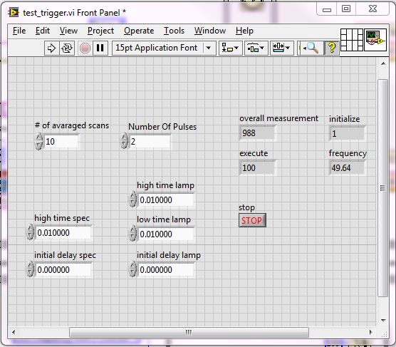

3. The time to take one measurement was surprisingly long with about 100 ms. If the system rotates with a frequency of 50 Hz, the expected time for the triggering would be two times the period of the generated pulse train of the lamp = 2*(0,01+0,01) = 40 ms plus (worst case) an additional period of rotation to wait for the rising edge of the light barrier, what equals 60 ms. The triggering of the spec should be negligible, as no pulse train is generated and the period is substantially shorter.
I've created a test-vi to measure the duration of the initialization of the tasks and the actual pulse generation, as can be seen in vi1.jpg and e2.jpg.
The time to initialize the task is almost negligible short with 1 ms. So the time to execute the pulse generation lasts 100 ms - where do the additional 40 ms come from? - Is there a way to speed up the pulse generation?

Answering the points
1) Your period is very close to frequency generator period: it is 10 ms initial delay + 5* 10 ms high time + 5* 0.1 ms low time = 60.5 ms + delay to start/finish. Sync pulses go with 20 ms. Your programmatic synchronization error is above 1 ms. You do not trigger from the right pulse and have these spikes (in the beginning and at 50-th iteration). Period variation between spikes is around 1 ms, as it should be.
2) "it often produces false triggering". We use almost the same scheme on the same PCI 6602 to generate sequence of 1000 pulses (at 10 MHz) with the rate of 9 kHz. The synchronization error with external signal is not more than  25 ns. Though we do not use pause trigger, but finite retriggerable acquisition, triggered by the delayed pulse (second counter in the example).
False triggering means bad settings.
3) It is not initialize, it is filling the settings cluster. The work with hardware starts with Daqmx start or commit VIs, and you include them in "execute" time.

First i want to thank you for your answer. I got some more questions relating to the answers:
1)  "You do not trigger from the right pulse and have these spikes (in the beginning and at 50-th iteration)." - Does that mean that the peaks are normal variance arount the expected value?
2) "False triggering means bad settings." - do you have an idea of common mistakes / or documents with help for troubleshooting?
3) By "commit resources" you can save ~20 ms between similar pulses, am i right?
expected value Blockdiagramm1: 60,5 ms
measured value Blockdiagramm1: ~80 ms
---------------------------------------------------------------> ~20 ms too much
expected value e2: 60 ms
measured value e2: ~100 ms
---------------------------------------------------------------> ~40 ms too much
Thanks for your time,
Konrado
Message 5 of 26
(4,850 Views)
You trigger from pulse 0. You finish 60+ ms later - missing pulses 1, 2, 3. You can not trigger from pulse 3 and need to wait for the pulse #4. It gives your 80 ms.
With the same timing the same thing will happen if you make it completely hardware based (eliminate all software ~1 ms jitter to restart task). May be this is happening in your second case.
One more thing: your pulse period is not exactly 20 ms, and you specify lamp period to be exactly 20 ms. It will give you 4% phase shift for the fifth pulse.
