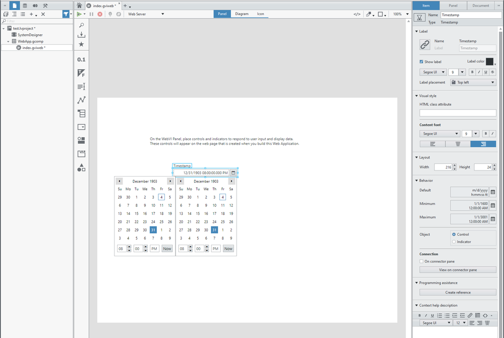

I'm evaluating NXG 5.0 Web Module. However, a simple control, e.g. timestamp or combobox, on the panel always showed double drop-down lists as blow. Anything wrong or any setting to make it normal? Thanks for any help.

On a clean Windows 10 machine I was not able to reproduce the issue but if I change the "Tablet Handedness" configuration I see the double menus like you described. I found a third party site with instructions for changing the handedness of the system called How to Set Menus to Open Aligned to Left or Right in Windows 10.
When set to right-handed I see the double menus as described but when I set the setting to left handed I no longer see an issue. I created Bug 1131100 to track the issue to see if we can find the root cause of the behavior.
One thing I noticed is that the double menu behavior only occurred inside the editor, but when using the "Run in browser" command or deploying the WebVI I did not see the double menu. So it seems like potentially the behavior may only occur when running in the editor and not in a built WebVI.

Thanks, Milan.
The workaround works. Great help!
