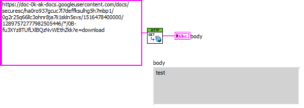

Use http get.
Your URL has a redirect link, so you would "get" it once with your original URL, parse the redirect, and "get" once more. Here's what I see if I use the redirect URL directly. 😄

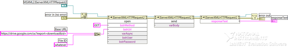

At the end I solved it by translating the VBA script to LV, but I think its overly complicated. Your solution is better as it requires no ActiveX calls. Thanks.
