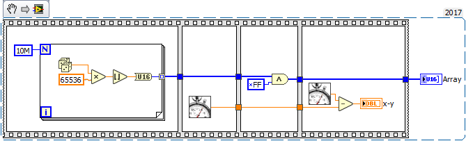

Hi Tinkerer,
for me a quick test of "U16 mod 256" for an array of 10M random U16 values resulted in
- ~20ms using Q&R
- ~4ms using AND 0x00FF
(For this special case the SplitNumber function needed ~18ms.)
You can make such simple tests on your own too:
