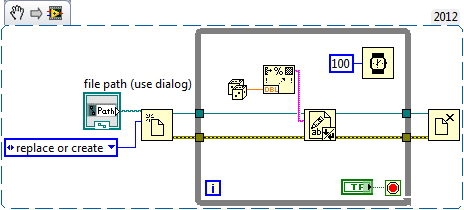

So in general when you want to write data to disk as it's acquired you follow this template of opening the file, writing to it continuously, then closing it.
If you look inside the export waveform to spreadsheet function you'll see that they're opening, writing, then closing. So, if that function does exactly what you need then you can just use its base code and move the open and close functions outside of your while loop. If it doesn't work exactly like you want then you can customize things more by starting from the base model above.
