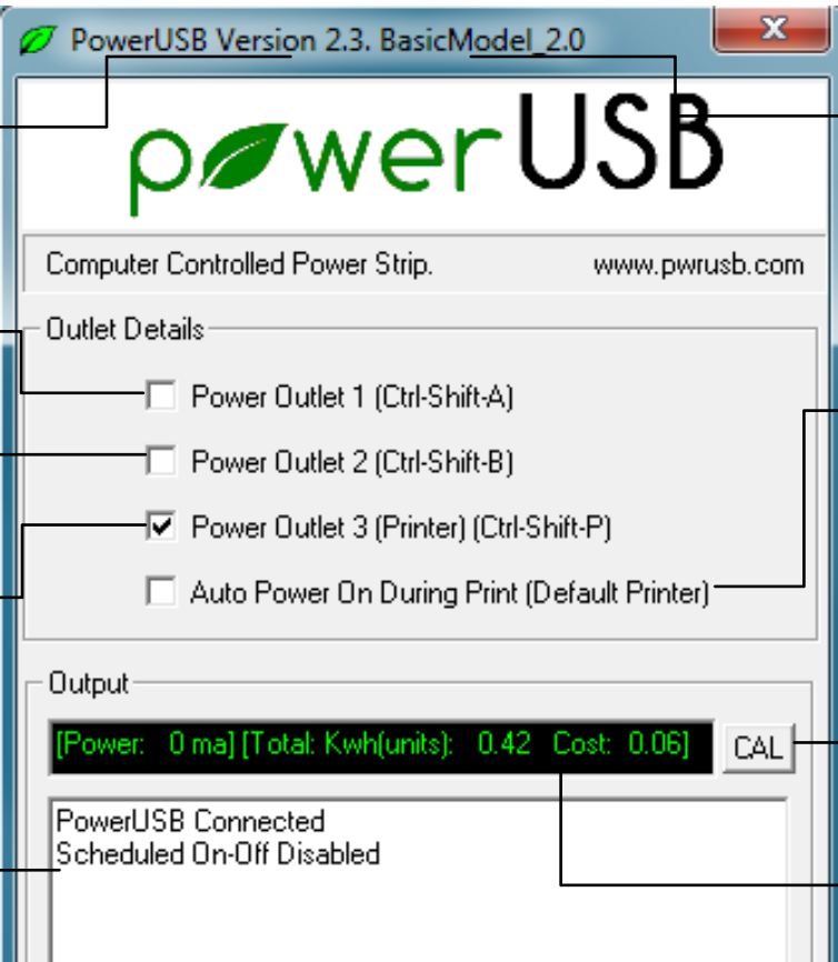

My ultimate purpose is to control the switch of a light lamp. I want to power on the lamp and collect the data through a DAQ simultaneously. I think instead of directly controlling the lamp, it might be easier to control the power which connect with the lamp. I searched such device online, and found one --- PowerUSB (http://www.pwrusb.com/) might be available to easily control the on/off of power by using its own software (easily click the checkbox shown in the pic). So my biggest question is how to connect LabVIEW with this external software? I have no ideas. Could anyone give me some clues?

In their download section, they have developer files.  Have you tried those?  I would imagine they provide a much simpler interface.

WHat do they have?  I imagine it is a DLL or .NET interface.  That is probably much easier to handle than trying to launch their UI and programatically send it key strokes or mouse button presses.  More robust as well.  You would be able to get some help from the forums with the interface if you have issues, but that is by far the best way to go.
