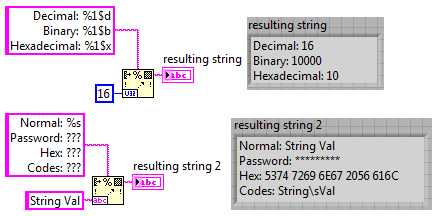

I am aware that numerics have display format specifiers (as shown in picture), but I'm wondering if there's a similar function for getting the display formats of strings?
I have shown what I want the output to be (although that output was clearly not generated by the code!). So, can I replace the ???'s with some valid format specifiers?

Hi JackDunaway,
What an interesting question.
I don't believe using that block you can... if you double click on it you can see what formating you can achieve.
However,  you can get these formatting options using a property node of the string indicator.
You can do this by right-clicking the string indicator >>  Create >> property node >> Display Style then place the block. Right click and change to write ..
Content Help:
"Sets the display style of a string object. Valid values include 0 (normal), 1 (backslash '\' codes), 2 (password), and 3 (hex). You cannot write to this property when the referenced string control has key focus.

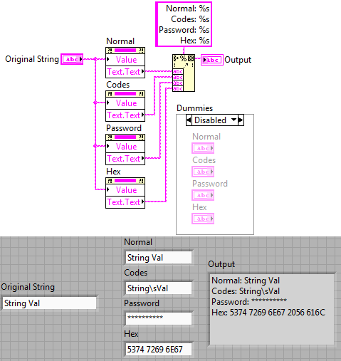

Thanks for the reply! Well, yes, I'm aware of one "bad" way this can be accomplished, by using the "Text.Text" property of some dummy string indicators:
Instead, I'm wanting some cleaner syntax. Needing to introduce a dummy indicator just to hijack a property of that object is a bit messy.
Looking at my example, one might argue "Well you only need one dummy string in a For Loop of 4 iterations, setting the Display Style from 0-3. That way you don't need four dummies." Right, but the principle remains... I'm interested in a Format Specifier (or potentially a VI hidden in vi.lib?) that eliminates the need for a dummy indicator.

Hi Jack,
I have written something along the lines of what you are wanting. It doesnt require you to write to a 'Dummy' Indicator as such:
Of course the refnum is not in the original, just something that labview does when converting to snippet.
The property node is the node for the 'Output' indicator, so not technically a dummy indicator as you would require this in the sub vi anyway.
Maybe not what you are after but works.
