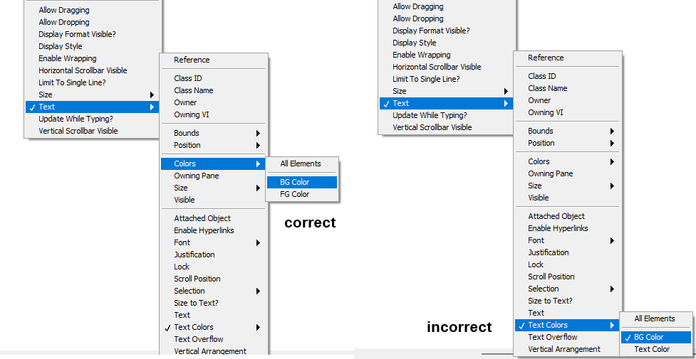

There are two different [Text.BGColor] properties and you can only distinguish them when showing long names for the properties. In your case, the font has a grey background color, so you are NOT doing it right. 😄
Make sure the text.text background is transparent.
(1,884 Views)
Accepted by topic author adrianslab99
Here are the two properties with (unfortunately!) the same short name.
(1,875 Views)
That was it, thanks for the help! So easy in the end...
