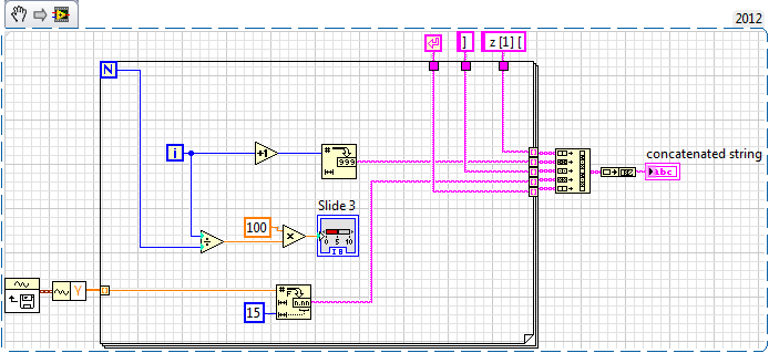

For some additional optomizations you can get a boost by using autoindexing tunnels and do your string concatinizations in one fell swoop (Yes, Concatinate String works just fine on arrays)

@Crawling wrote:
I had it solved after removing the 'wait until the next ms multiple' vi from the loop iteration.
Jeff already pointed out some more optimizations, but here are a few more things that are wrong with your VI:
  • Your shift register is uninitialized, meaning that its contents grow with each run and eventually you will run out of memory.
  • Even with 1.5M samples, it will only a few seconds, so the progress bar is not really needed.
  • If you like simpler code, you could do something as follows (it is very slightly slower that Jeff's but probably worth it for easier code maintenance and diagram real estate.) 🙂
(I left the CR at the beginning like in your code, jeff move ot to the end of each segment. Not sure what you really want)

That is scary. does parallelism effect speed?
My code slightly faster than Christians? That has to be a compiler optimization bug. But, I'll cherish the moment.

Dear Jeff,
Thanks for the input.  By the way what is the vi connecting between the interleave 1-D array and concatenated string.  I do not recongize the symbol.  I believe it is to convert the 1D string array to string. The closest I could get in my search is byte array to string which is incorrect.

It is Concatenate, on the string palette.  It works on arrays.
Jeff posted a snippet, so you can drag that image to a block diagram.  Then use context help to hover over the functions you are not familiar with.

Actually Bill, that's "Interleave arrays". One of those resizable array functions that need a bit more press in core 1.

He was asking between Interleave Arrays and Concatenated string which I assumed he meant was the indicator terminal snce that is what the indicator was labelled.
Concatenate is between the Interleave Arrays and the terminal.

Silly mobile version.... Needs an inline viewer for images.   I appologize Bill, you are correct.
