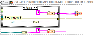

I have an issue with one specific VI, it I open that with LabVIEW 2009 SP 1, a lot of the string constants get resized until only the first character is visible:
I am not sure why it happens with this specific VI, but I can tell it's quite annoying to debug this kind of code.

Windows 7, but to clarify, the font is not mangled. It looks like their is a 'Resize to text', witht the text length set to '1'.
Ton
