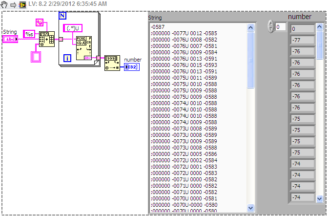

Maybe the last part can be simplified. Please see the image.
I modified your input a little bit since your data only contained "minus". I changed row 2 to have a "space" which should be interpreted as positive sign. Moreover, row 4 shows a explicit "plus" sign in the ninth position. Note that both space and plus are correctly interpreted as positive.
Consider sanitizing the input. The 0th-row with "-0587" does not follow the syntax of all the other rows so it should be removed.
