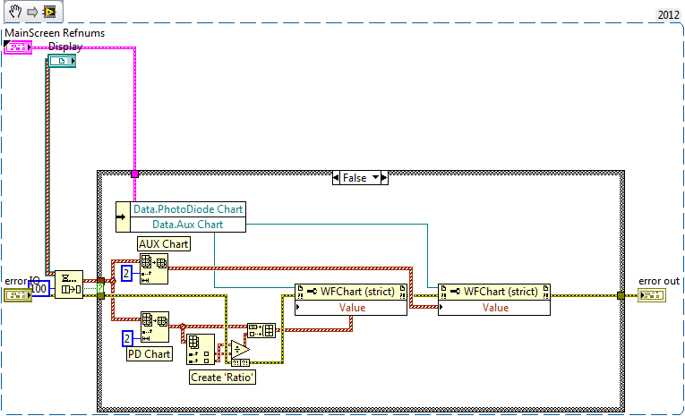

Sure.  There is a DAQ handler that makes AI read calls, and writes 1-D waveforms to a queue:
Then a Display Handler reads from the queue. spilts the array of waveforms for display on two separate charts, and divides one waveform into another to create a ratio:
Thanks.
