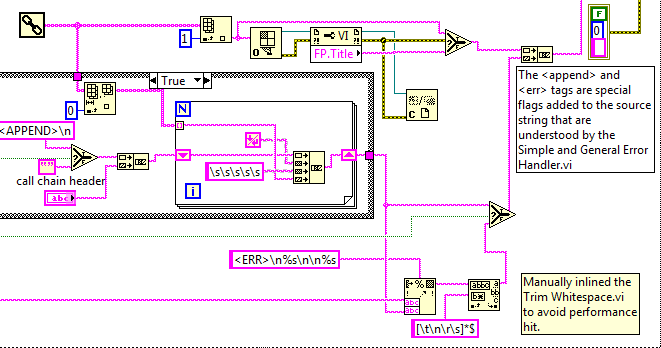

I doubt that the shared clone setting plays much of a role here, there are some deeper issues.   A rather amusing VI in a few ways:
In order to show the VI Title instead of the Name you Open a VI reference which is going to stick you into the root loop.  10 reentrent clones simply means 10 copies waiting in line for the root loop.  A non-reentrent version would simply have 10 copies waiting to run.  Minus the root loop issue, reentrency is the way to go, and on a desktop machine shared clones is typically quite effective.
It can't be a slow VI, look Trim Whitespace was inlined manually to avoid a performance hit!  In a loop maybe, but really, shaving off the overhead of a single subVI?  That's optimization.
But wait, all of that and much, much more is given right back by the use of Delete From Array to remove the first element of the Array.  Bad on so many levels.    Delete From Array is a data copy machine, and now you are doing one needlessly.  Array subset is your friend here, tells the compiler you are only reading, nothing to get excited about. Pull it outside the case structure, you are ditching the first element twice in the two branches.
Concatenating strings in a loop, also a recipe for fun.  Often there are ways to leverage Array to Spreadsheet string for better performance, or build a string array and then concatenate at the end.  Probably not a big deal here, how big are call chains really, but if you are inlining subVIs by hand then you should really be frying the bigger fish.

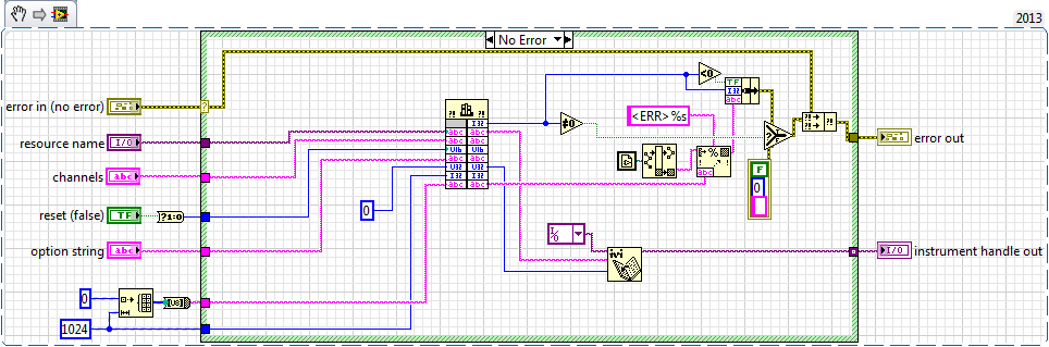

I'm thinking something like NI DCPower uses
which I bet out-performs the snot out of error cluster from error code.vi
