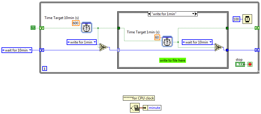

I have developed a VI that will read data from sensor usind DAQ and writes the data contineously to a text file. My problem is the file is getting very big. I want to to read data contineously and show it on front panel (i.e. Graph) But I want to write this data to a text file after specific time and for specific time (e.g. Every 10 minutes - write for 1 minute). Can anyone help me with this ?

This should not be too difficult using timers. Open the file, save some data, wait, save again, repeat, then close the file. It's kind of hard to be more specific if we can't see what you've already done. Show us what you have.

elapsed timers will do the trick...but then again, you could use the CPU clock if you wanted on the ten count by using the 'seconds to date/time' and 'quotient and remainder'

Hi swap15
I quickly rebuilt the code Apok was suggesting. Check out its functionality i.e. with the highlight mode.

Hi Raff,
thanks for the reply.......but I have already implemented it and its working fine...........anyways thanks again for the help...
