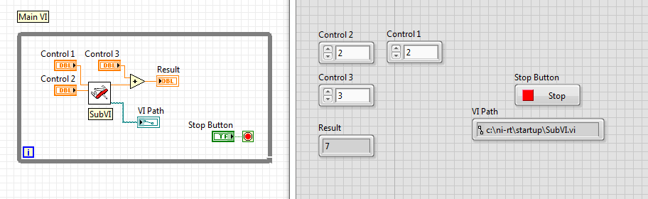

I built an example code VI that I'm running on a cRIO-9075. Here's some screenshots of what I've done.
I have a main VI that sends two numbers to a SubVI and then adds and displays the Result.
The subVI is just multiplying the numbers and outputting them. But, more importantly its extracting and outputting its own path.
I ran this these VI's in Interactive mode (Just pressing run to deploy my code) and the output VI path for the subVI is shown above. So my guess is that when you're running in activation modethis is where the SubVI is being stored. I would maybe try using this VI path to build your reference and see if you can Call your subVI that way?

Hi Tim,
Thanks for your example but it's somewhat trivial, could you try the same example but launch the sub-VI dynamically using the start asynchronously command and see if it will still launch it when you hit the run arrow?
