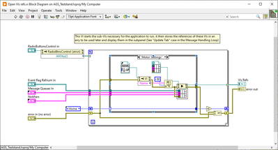

In an attempt to run asynchronously multiple sub-vis that are controlling a testbed, I thought that it could be a good idea to have the same "Stop" event (and especially the same Reg Events refnum) to make them all exit nicely (they are all base on the Prod/Cons event template).
But it looks like it is not working.
My guess right now is that there is some competition between the different event loops running asynchronously, the first one to read the event would delete it and the other wouldn't be able to see it? Is that possible? It seems that according to this thread from 2007 this is the case, but I would have thought that 14years later that might have changed.
A quick test showed me that running multiple Reg events and sending one per loop works fine, is that how you would deal with it?
Or maybe also having multiple Prod/Cons running asynchronously and sending messages and events to each others is not a good idea?

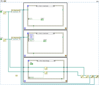

Hi Vinny,
it's no good idea to use shift registers with "default if unwired" tunnels to hold references!
(Especially when there is more than one event case in the bottom loop…)

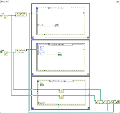

Woopsie
Yes, I understand that, a mistake while trying to draw a quick example 😬 thank you for noticing. The other event case in Loop 3 is checking on the Quit button (like the other loops btw)
Do you have any advice concerning my first problem?
As I see it, my current options would be:
  • Create 1 "Stop" event and multiple Reg events (one for every Sub-vis that are running asynchronously) and I pass the ref of each sub-vi in the call async function for every sub-vi. A bit like I'm doing already, except that I have only 1 Register Events refnum (which I believe is the issue
  • Create 1 "Stop VI" event per sub-vi with only one register for event refnum. That way every subvi can technically see all dynamic stops, but will check only the one they are concerned with.
  • There is also the possiblity to send a message to all loops, but then I will have anyway to create an event for all of them...
Does it make sense?

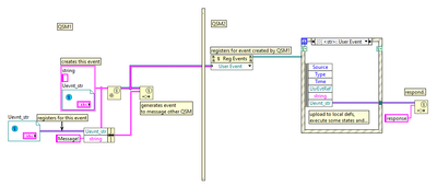

If you're not familiar with using user events in a self-addresses-messaging kind of way, it's become something I use often and has been working well for a long time, something like this:
where "QSM1" and "QSM2" are different vi's - and QSM1 asynchronously launches QSM2 after registering for the event that QSM2 is passed.   When QSM2 generates the event, it includes an event that it is listening/registered for, and when QSM1 handles the event generated by QSM2, it can respond on the event that came with it.      I wonder if I worded this well enough for it to make sense, or if it's just some user-event soup 🤣    you can also do this with queues too but the handoff is a bit more complicated...

If I understood well:
You create an Inception event where the data type is a cluster of <1 string + 1 "user event - String data typed">  that way your sub-vi can confrim reception of the event by sending a response to the "User event - Str data typed" -  Correct?
Tbh I don't really see the point of it 🤔. Notifiers do this very well, no?
yep, you got it.
And regarding your first question, I use user events for this kind of stuff all the time so I'm inclined to say it's just fine.
And for the example/idea i mentioned, yes you could certainly use notifiers if you wanted to, but the self addressed messaging structure allows you to support data in the messages if desired for more than just stop messages...
I tend to just use one string based event since most things can be interpretted in the receiving vi, and unflattened/flattened to string if need be... it's also common for people to use string+variant data clusters... that user event is how i tell the other process what to do, including when to stop running.
I'm not suggesting it's necessary for simple stop messages, but when it comes to multiprocess communication some form of async messaging is a must in my opinion.

You should use one Register For Events function per loop. Do not split the Register For Events wire to connect multiple Event structures.
Your code will work fine as you've written it, but I'd make one minor change- wire the Unregister For Events to the output Dynamic Event Registration terminal. It should work the same (assuming you're not switching events inside the case structure) but it'll be a little more clear what's going on, and will be tolerant to switching around registrations internally.
You can also split the User Event refnum into multiple Register For Events nodes if you want to send one event to multiple Event structures. The User Event itself can be split as much as you'd like; the Event Registration Refnum should *not* be split (for purposes of multiple registrations... the way you have it in your first post is fine since you're using the split version to unregister).
I have found that the documentation is sometimes correct and sometimes wrong on this one, and it's been fiddly in the past. Using multiple RFE's means you know for sure you won't have race conditions. I can theoretically come up with reasons to just use one, but be warned: this kind of code WILL break at some point in the future. See the discussion and my example code in this thread:
https://forums.ni.com/t5/Actor-Framework-Discussions/Stopping-multiple-helper-loops-with-one-user-ev...
This is specifically discussing the Actor Framework, but the points about event registrations still apply. Note that the "helper loops" discussed in that thread are basically just "second loops" that often have Event Structures in them.

Getting back to the initial question:
Create 1 "Stop" event and pass that 1 event ref to multiple "Register for Events" functions.  Each Event Structure that will react to your "Stop" event needs to have its own call to "Register" to get its own unique Registration Refnum.
It's also advisable to make sure at exit time that you get through all your "Unregister" calls before you Destroy your "Stop" event.
