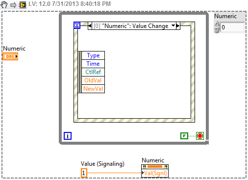

It triggers the Value Change event:
Message 7 of 10

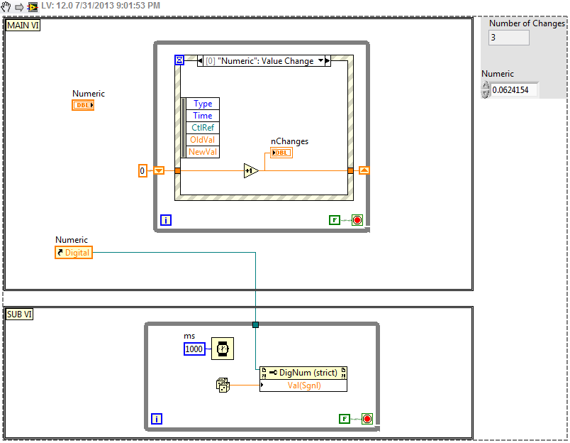

Decouple the property node and pass the control's reference to the sub VI. Here is a VI snippet in LV2012:
Message 9 of 10

@vivianbritto wrote:
Given a user control in a SubVI, how can I use the value (signalling) property node to make it as though the user flipped the switch in the front panel?
You don't want to.  That is just a bad architecture.  Separate the code in your Main VI into new VIs and call those.  Working around the event structure is just going to make things way too complicated.
