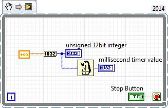

I'm notricing two other things:
  1. When Ferquency has a meaningful value for PWM your delay will get very large!
  2. A delay of Inf contains a HARD Limit where LabVIEW saves is from ourselves! IDNKT moment
In theory there is exactly one ms timer value that is a multiple of 4294967295 the example code runs much faster than once per ms timer rollover.
