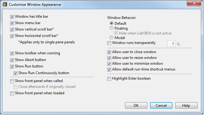

I made no changes to the default window appearance.  Here is that menu:

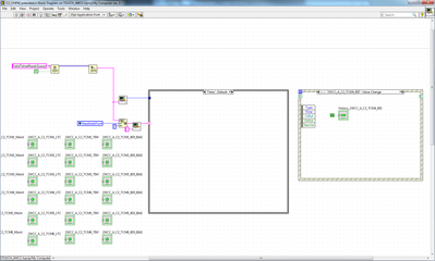

Here is the code of the sub VI...it doesn't really do anything right now, as I am working through the basics of the display.  I will indeed be adding a loop since the subVI pops data from a queue, but to eliminate variables from what could be causing my issue, I removed it:
I'm not sure how I would get rid of the X...I didn't see a 'window appearance' setting that did not include it by default.  Regardless - as you can see I'm not using any loops in my subVI right now, so I don't know why the main VI would still think it's running even after I click the X to close it.

"Allow user to close window" removes the X
/Y
No it keeps the X ON.

Remove the Event in the Sub VI. Since you are closing the window (X) your event structure inside the code will wait until it gets the proper event and your main VI cannot trigger since it is alread locked inside an event. That is why you front panel gets locked when you click on your main VI.

I can't see exactly what is in your subVI from the image.  But I do see a Queue and an Event Structure.  Either of those situations could cause a "wait infinately" situation.  The Event Structure is the likely culprit here though.  I actually like to handle the Front Panel Close event if you already have the event structure.
