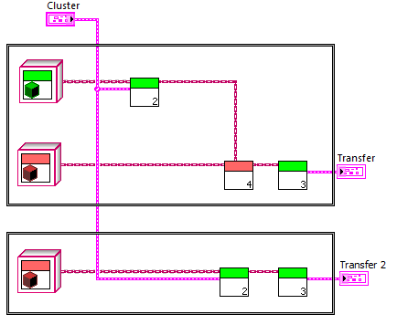

I need to do the first option, because there are more VIs called before the parent is ready to transfer the data to the child. The calling of the parent methods works. At least for methods created after the children. The older methods are not always recognized, but when I create a new dynamic dispatch and copy the whole VI it works for some reason. The classic inheritance works now.
I want to access all the data from the parent defined in parent.lvclass without creating a cluster in the definition of the class (which is already a cluster). But this has more cosmetic and accessibility reasons.

@s.h._tech wrote:
@Intaris wrote:
The lower of the two is the better option - much more efficientThe lower of the two is the better option - much more efficient
Red point: Hmm... Why does the parent transfer data to a separate child object? You should just have a Child object, and store the necessary "parent-level data" in the same child object, using the Parent VIs (e.g. iniparent.vi).
Blue point: I'm confused what this means... I suspect at some point you've changed how you're creating something, perhaps from the wrong way to the right way, and now it's "working", but I'm still unsure what you're doing, so I'm not sure it's right! 😞

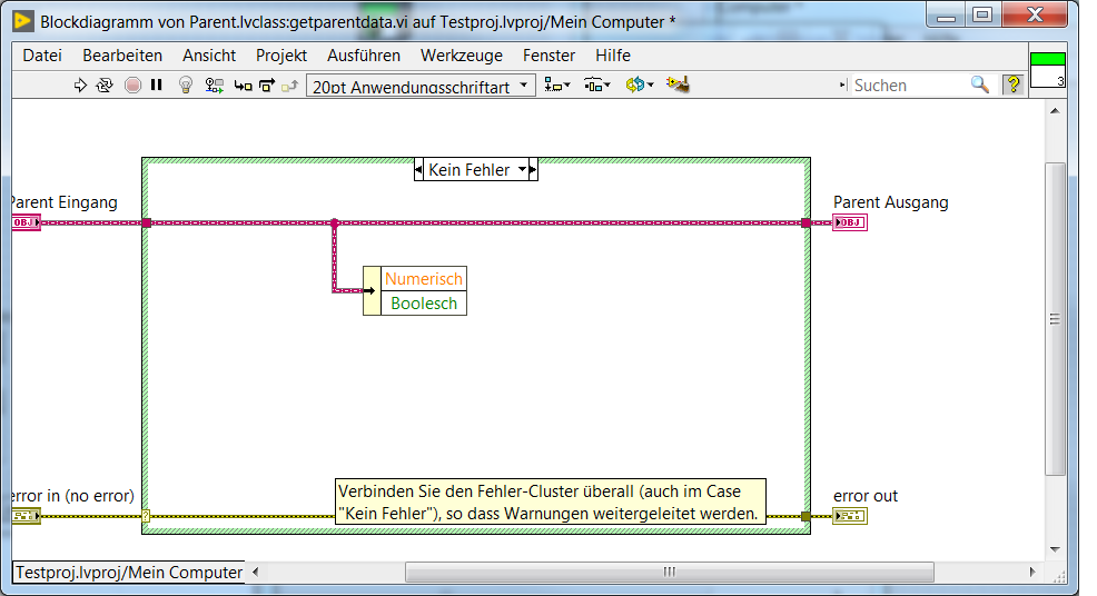

From the code you just attached and the block diagram you show in your reply, you could now use the idea I suggested some time ago with a separate typedef'd cluster, not used in the private data, but only as an output. This would in your example be {Numerisch, Boolesch}.
If you don't want to bundle data specifically for output (not inside the private data, but in the accessor methods like "getparentdata.vi"), and you don't want separate accessors ("Get Numerisch.vi", "Get Boolesch.vi") then you must instead consider alternative ways to get/use the data.
I will use this method. I am used to have direct access to all variables of the super class without the need to implement specific setter methods from the parent (they share the same set of variables declared in the super class). It would be nice to unbundle the Elements of the 'Parent' directly in the 'Child'.
And this is precisely what you can't do.
You create accessors for the parent, and use these inthe child isntead of direct cluster access.
This is how it works.
If you want to re-create all of the data in a child, then it's going to be really inefficient.
