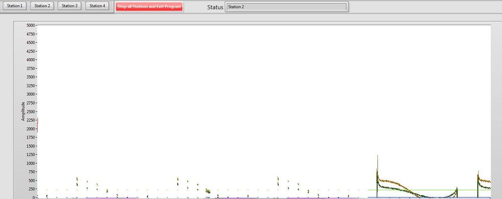

When I force redraw every iteration of the plot loop in the posted code, the whole screen is continuously blinking showing me all 4 charts alternatively - Even though the other 3 subpanel's visible state is FALSE.  There is no data loss when switching stations but needless to say having all 4 stations blinking in my face isn't going to work.
When I have the force redraw run every 100th loop, I have the screen blink only once in a while, redrawing all 4 stations.  When I come back to a station, I see a choppy chart of older data.
Conclusion:
Waveform charts must be visible in order to draw data.
I will still welcome new ideas, old ideas, or feedback on posted code.

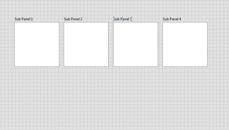

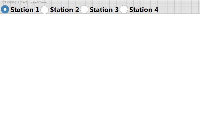

1. Main big sub-panel where the current station(async vi) is displayed
2. 4 little sub-panels hidden from sight.  Each displays the remaining unseen stations

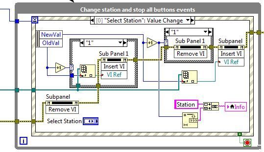

3. When a different station is selected, the sequence is - remove vi from main panel, insert that vi to the little sub-panel designated for it, remove the vi from one of the little sub-panels, insert it into the main sub-panel.
* This way the waveform chart keeps historical data (up to however much you allow it to in the "Chart History Length.." property.
** Have been running this setup for many days and there are no performance, CPU, or memory issues.
*** The "little" sub-panels are "out of the screen" but must remain visible.
