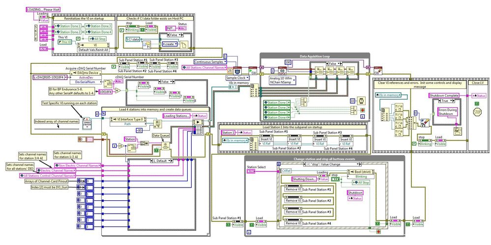

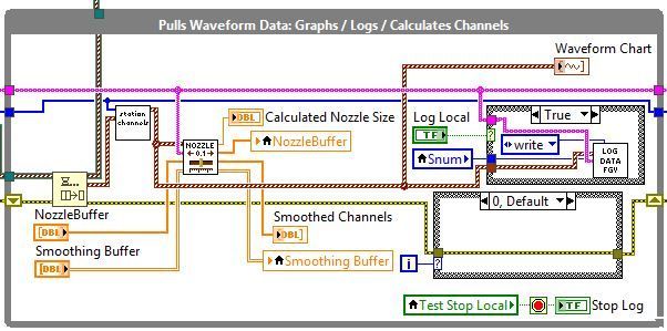

Current situation:
- I have 4 stacked subpanels with an async instance of my subVI inserted in each one.
- 3 of the subpanels are invisible at a time.
- When I switch away from a subpanel and come back to it, it does not re-plot the data anymore, BUT there is a blank space in the plot for the time it was not visible!
Questions:
1. What is a panel activation event?
2. If all 4 stacked subpanels are visible, can I programatically bring one subpanel to the front or move the other 3 out of the screen?
Finally, my top level VI and the plotting loop in the subVI:
Top Level.  The other events just hide/unhide subpanelsTop Level. The other events just hide/unhide subpanelsChart LoopChart Loop
Message 16 of 24
(1,786 Views)
