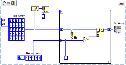

What do you know about arrays and how LabVIEW handles them?  Do you know how arrays work with FOR loops?  If you have a 2D array, and I say "A For loop will give you the rows, one at a time", and you want to do the columns one at a time, can you think of an array operation that will exchange rows and columns so you can use the For loop to do columns, instead?
Put some of these ideas down in a Block Diagram, test it out, see if it works, and if it doesn't, post the code and ask for help.

No need to change the dimensions of the array, if that is what you were implying.
(8,083 Views)
Transposing the array, and using autoindexing on the 2-D array subtracting the 1-D array.   Then transposing the result is a whole lot less code.
(8,057 Views)
Quite true.
However, I do not know whether it has changed in LabVIEW 2014, but transposing an array made a copy in older versions. For big arrays it was an expensive memory option for a slightly smaller ampunt of code. For small arrays, like the example here, I wholeheartedly agree with you.
