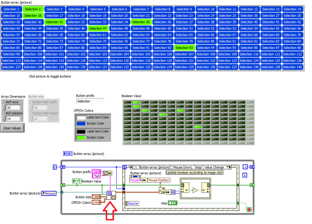

Sometime a picture control is the best and most flexible solution. You have full control over every pixels and the picture function offer a rich selection of primitives (circles, lines boxes, text, etc.) to simplify the task.
here is a recent example.

You talk about a "control" (i.e. not "indicator"!) and it is not obvious how the user is supposed to interact with it. For example, do you want to user be able to directly change text and color, or is it sufficient that these are handled by the code. My above example allows select/deselect, and maybe that's all you need.

I have not set it in stone yet, but basically I need a control that I can select or deselect multiple items at once. Possibly be able to double click one and open an event. But I also want separate indication vs selection.
The picture example above looks interesting. I might try something like that. Basically, if I took that and had a highlighter were two of those green ones were selected, for example.

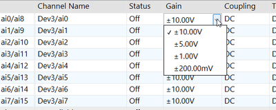

I use a table control and use the invoke node @Kyle97330 suggested. Once I know the cell the user clicked, I use a text ring that "appears" at the same cell at the same size that the user clicked. The text ring can be populated programmatically depending on cell chosen. The test ring disappears after the user selects a value or leaves the control. See below. This allows some flexibility with a static 2d string table control.

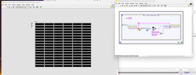

It really depends on what you want to do. Here is a cluster array to do the same thing:
The cluster will also give you flexibility to do more what your control. You can add check boxes, pictures, lights etc...
