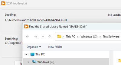

I have upgraded from LabVIEW 2017 to 2024 version and as I am upgrading my previously saved source code, I ran into an issue with the dll used for communication with the programmer;  Find The Shared Library Name "GANG430dll".   I have Texas Instrument's "MSP-GANG Programmer" installed onto my PC but I am not sure if I need to install something else, or if this is even compatible with this version of LabVIEW (2024).  any insight would be appreciated.

Does the "MSP-GANG Programmer" install directory (probably somewhere in Program Files or Program Files (x86) ) contain the DLL?  I would start by checking there.

Did you change the bitness of your LabVIEW installation?
Is that DLL provided for 64bit or 32bit environments?

it looks like I had the dll in the wrong directory.  Moved it over to where my code was calling this out to and it worked now, thanks !
