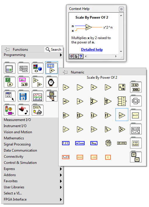

Just realized it's not easy to get help for functions while using quick drop. If you Show Context Help (type ctrl-H) and hover the mouse over a function in the palette, it will show a brief explanation of the function. You can click the Detailed Help for more info.
Hint: The function you are looking for is in the Numeric palette
