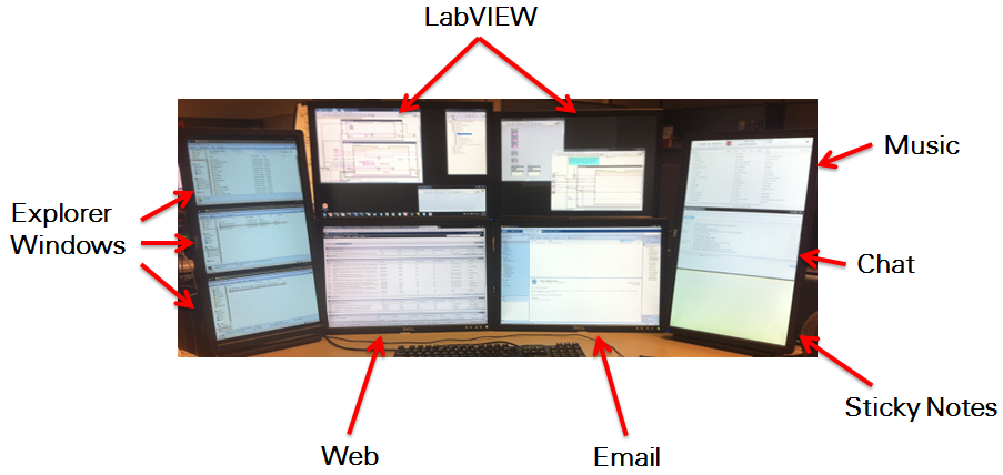

Here's what my 6 monitor setup looks like:
The contents on the two side monitors and the two bottom monitors are very static. I always have 3 explorer windows open on the left. I always have music, chat, and sticky notes open on the right. And my web browser and email client are always on the bottom. Since those windows never move, I always know where they are.
Now the top two monitors have all sorts of stuff going on. LabVIEW, Paint (for screenshots), PowerPoint, Word, etc...but it's never felt like a chore to me to manage two monitor's worth of windows. One of the only times where things spew onto the other monitors is when I'm debugging some hairy LabVIEW bug, and I have the probe window and tons of paused VIs spread out all over the place. But that's not an everyday situation, so it doesn't feel particularly burdensome to have to manage all those windows when hairy bugs occasionally come up. Any pain associated with window management is quickly overshadowed with the euphoria of having found the cause of the bug. 😉
As for taskbar use, it's kind of a non-issue when I know where almost all the windows are all the time. One trick I do use is the Window-1, Window-2, Window-3, etc. keyboard shortcuts for giving focus to the 1st app, 2nd app, 3rd app, etc. in the taskbar, respectively.
I guess to look at things more generally, I use so many monitors specifically so I *don't* have to manage anything, because almost everything is visible (i.e. not hiding behind some other window) all the time.

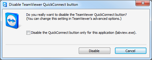

Back on topic a little I found the issue and was able to fix it.  Turns out it wasn't Displayfusion at all, it was TeamViewer.  I thought it might have something to do with the extra buttons that are put next to the Close, Minimize, and Maximize buttons of each window.  Both Displayfusion and TeamViewer add little buttons that can have special functionality.  Displayfusion defaults with span across all monitors, and move to the next monitor.  I didn't like these buttons so I disabled them.  But TeamViewer also added one for their Quick Connect.  Basically it allows you to share a window quickly with another machine.  I never used the feature but clicking on the button gives you the dialog attached.
Here I tried the to just disable it for labview.exe and all of the sudden my Super Quick Drop worked again.  This feature can also be disabled in the options.  After making this change all versions of LabVIEW now are working.
