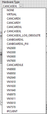

I've checked the code of the library but in the cluster where the HW is set I only found a list of devices but the VN5650 HW is not here. I want to add it but I don't know which document has been used to get the values of the HW. Has anyone tried to do it?

Troy's drivers are a wrapper of the XL DLL provided by Vector.  They document it here in a pretty detailed PDF.  My code is a further class wrapper around it, so that it is easier to integrate with other CAN hardware.
