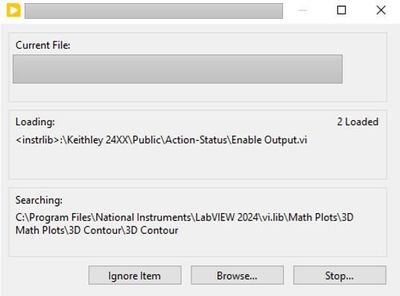

Attempted to mass compile the target directory - it worked but the mass compiling status pop-up is displayed.  This is creating a bad UX and won't be appreciated when deployed.  Is there any way to suppress this pop-up and carry the mass compile in the back-end without being notified?
Mass Compile Window to be hidden:

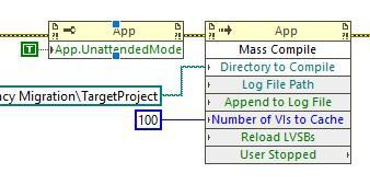

Node used to initiate mass compile:
