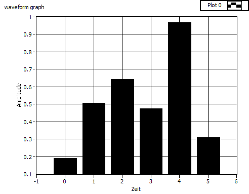

Hi Onjal,
no, you cannot swap axis on a chart.
Use a graph instead:
And PLEASE replace this silly sequence structure by a FOR loop to read the values of your 6 sensors…

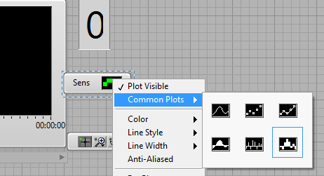

At this point, I am not able to "clean up" the vi.  I did wire a waveform graph out of the combined signals function and still cannot get it to display a vertical bar for each sensor.
Message 3 of 10
(6,413 Views)
Message 4 of 10
(6,407 Views)
Okay that helps.  Now I have bars but they are all superimposed on each other at x value of 0.  I changed the scale range to 0 - 8, with no change.  Any thoughts on how to show each sensor 1 through 6 along the x, as in the xcel pdf I posted?

If you just want to show a bar graph of the current reading, it has nothing to do with a "chart".
A simple solution would be to use an array of clusters, each containing a tank and a string, for example. Here is a quick draft.
(On a side note, your sequence structure is not needed. There is also way too much duplicate code (You could do the scaling in a FOR loop or subVI, for example).
Message 7 of 10
(6,381 Views)
Thank you Altenbach for the insights.  The vertical bars are just was I was looking for as a visual.
