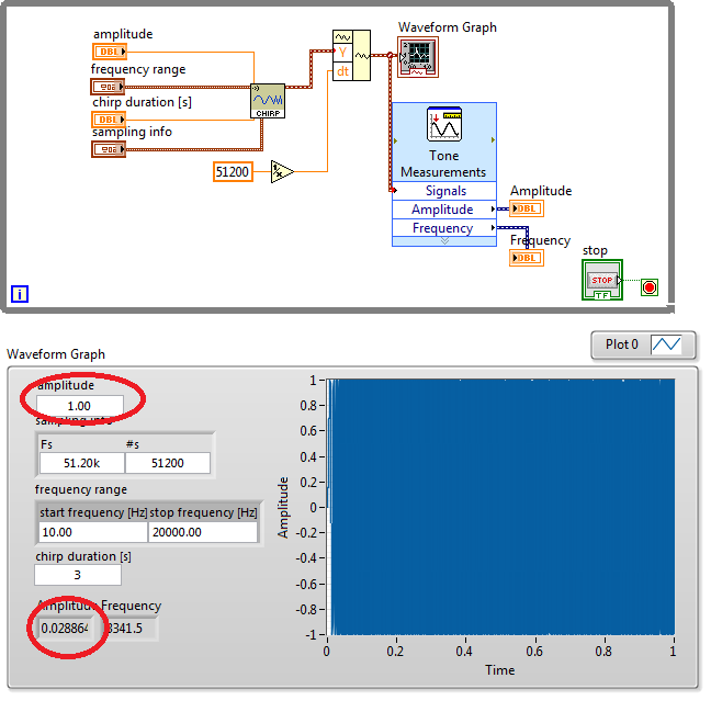

Why is the amplitude of my Sweep Sine decreases?
I wonder why increasing my number of samples, which is in my VI set to 51200 samples, results to an output amplitude of my sweep sine to decrease. However if my number of samples is small, let's say 1000 samples, the output amplitude from the Tone Measurements VI is close to one which is 0.968709.
How can I adjust in order to have the correct value of the amplitude. I need the amplitude to be exactly one, because I will output this in my DAQ.
Here is my VI.

Obviously your chriped sine getting to 1,-1 - very close to those values of amplitude, your just not able to see it, try to see it with comparison that will light when the values of the amplitude are bigger , let's say than 0.999.

Although I agree with the sampling rate discussions above, you might consider normalizing the output of the Swept Sine to One? There is even a built in VI for it: "Normalize Waveform.vi"

The use of Tone Measurements.vi is largely meaningless. Read the help for that VI.  It finds the frequency where the amplitude is the largest. It uses Fourier transform techniques to find that frequency. The Fourier transform of a chirp ideally is a constant. Because the actual chirp does not cover an infinite frequency range and last for infinite time, the spectrum is modified by the effective window. Thus the peak of the spectrum is approximately at the center of the frequency range.
Drop a spectral measurement VI on the block diagram and plot the spectrum.
When I extract a subset of the chirp array and feed that to Tone Measurements I get much more reasonable values. Subset starting at sample index 15000 and having length 50 samples returns Frequency = 5876.21 and amplitude = 0.99999. The graph shows about 5 3/4 cycles in about 1 ms, which is consistent with the measured frequency.
