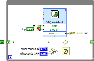

Hello, I am trying to create a VI that switches my relay on for a specific amount of time and then off for sometime, on repeat. switching it on works but i don't know how to switch it off and repeat. i have attached my VI, please do tell me what alteration is necessary to make it work.

Hi Doha,
To switch ON you send a TRUE constant. Which constant is needed to switch OFF?
Hint: to repeat a certain task it would help to use some kind of "loop" construct…

I know i need to put a false constant but I'm not sure how to connect it.
I have attached my VI.

Hi Doha,
Then you should takes all those (free) training resources offered in the header of this LabVIEW board!
To give an idea:
