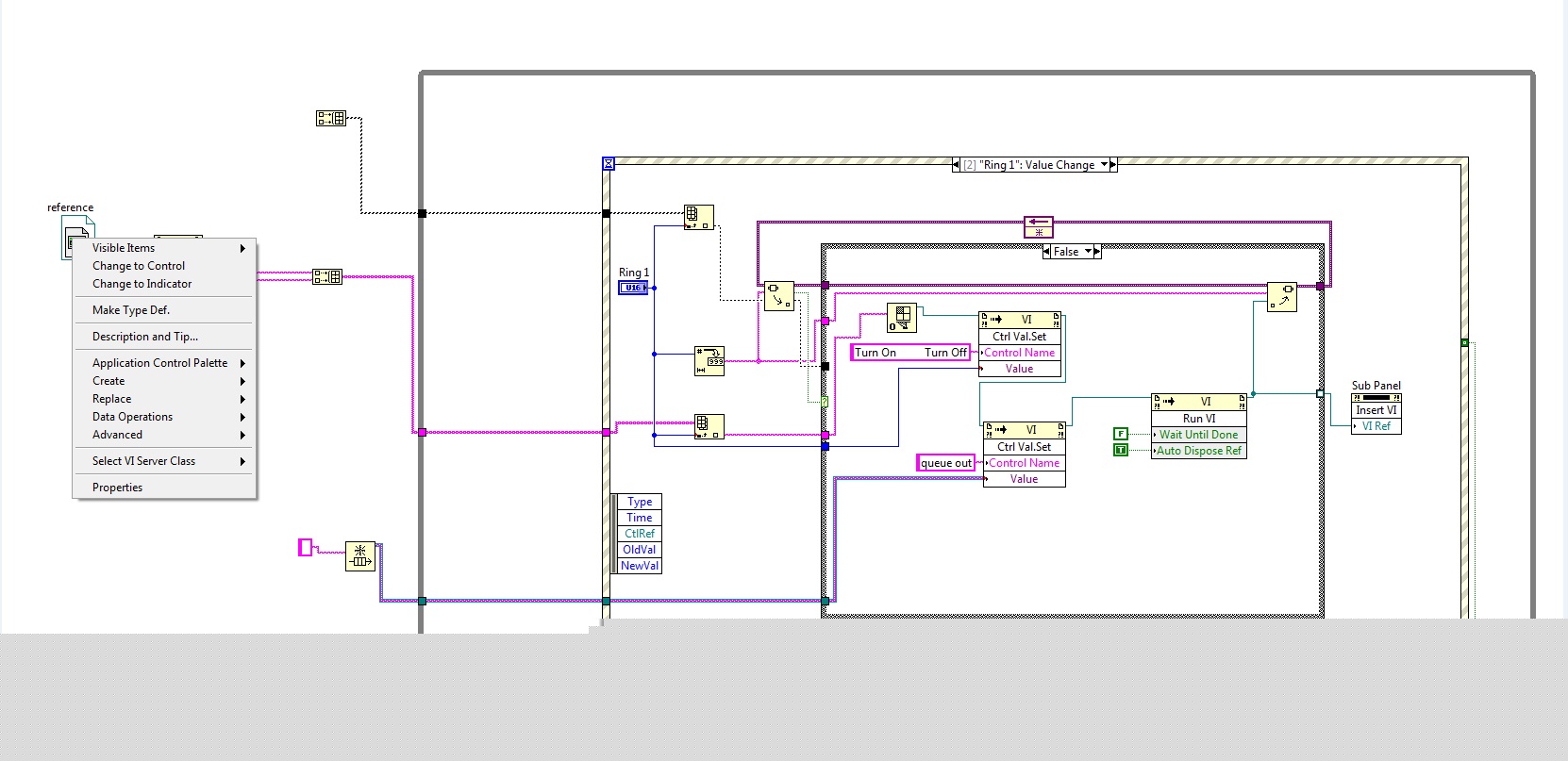

Btw, when I try to browse for path, this is all I see. Smiley Frustrated
